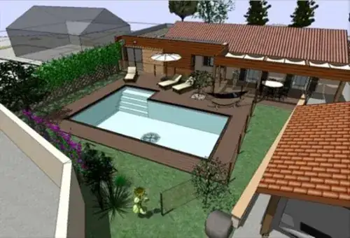

A very easy 3D sketching tool is Google SketchUp.
"SketchUp is the finest (and most innovative) tool available for anyone designing anything from coffee pots to skyscrapers." – McCall & Associates

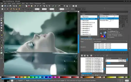

Continuing the Open Source tradition established in the present answers and comments, I'll hereby suggest the vector graphics editor Inkscape:
It will definitely do what you want, and the many features should make the learning curve worthwhile to climb - here's an Inkscape tutorial for 3D.
EDIT: for Greek letters, maybe you'll need to type the Unicodes [PDF] by first typing Ctrl+U.
