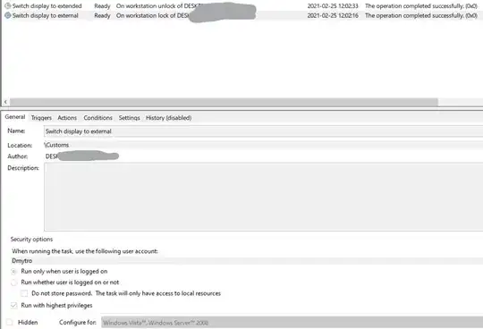

I have a laptop and an external monitor, so I call displayswitch.exe /external to only use the extended monitor and displayswitch.exe /extend to use both.
Also, to use both monitors for one user and turn off the internal monitor when the screen gets locked, I added windows tasks that gets triggered on workstation lock and unlock:
The one on lock has "Run with highest privilege" flag turned on.
