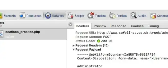

I’ve recently started using Chrome for development because I’m sick of Firefox’s huge memory footprint. Everything’s going remarkably well, but I just tried to view some posted data in Developer Tools, but I can’t seem to find it. I’m confused; I’m sure this used to exist in a POST tab, in the Network part of the tools.
screenshot
I tried looking through the headers, but there’s nothing in there either. Where has it gone‽

    Isn’t the data right there in your first screenshot? Look at the `Content-Disposition` field; it says **form-data** followed by a `name` field. – Synetech Mar 02 '12 at 21:48

  • You need to make sure to select the correct file. It looks like you did in the screenshot, but are you sure the data is not associated with something else? You can check the source code to see what file receives the data by looking at the `action` attribute of the `form` tag. – Synetech Mar 02 '12 at 21:47
  • As you can see, that's the only file. I was definitely selecting that, but still no luck. – Leonard Challis Mar 02 '12 at 23:00
    It looks like the data is right under your nose, in the *“payload”*: **Content-Disposition: form-data; name="xUsername…** – Synetech Mar 03 '12 at 00:36
  • Yes it seems to be in there - though that's not the Post tab or form data list. I now know _why_ it's going that however (see other answer). – Leonard Challis Mar 08 '12 at 16:19

It seems that a) there isn't a Post tab anymore, now there is just the Form Data list that is usually present when you use the POST method for an HTML form. I realised that when you use enctype="multipart/form-data" in the tag, you won't get the Form Data list, but you can still see the data inside the payload list as pointed out by @Synetech.
