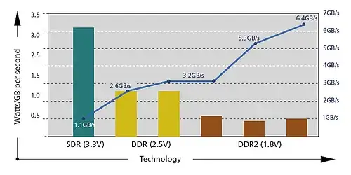

In general, each DIMM will consume roughly the same amount of power. The more RAM you add to a system, the more power it will consume (RAM is always on and ready for use). The following diagram is from Micron:
chart of RAM type vs. speed vs. power consumption
The line points represent the speed of the RAM, and the bars represent the power consumption (in Ws/GB - Watt-second/gigabyte, or Watts/gigabyte per second).
This yields the following figures (as averages) for each DIMM:
SDRAM = 1.1 GB/s * 3.0 Ws/GB = 3.3W
DDR   = 2.9 GB/s * 1.5 Ws/GB = 4.4W
DDR2  = 5.0 GB/s * 0.5 Ws/GB = 2.5W
Just a reminder that we're dealing with averages here, and remember that the figures above are for each DIMM. Modern DIMM's consume less power than others, and overclocked/high performance modules use more. In general, the figures above are accurate enough for most means.
