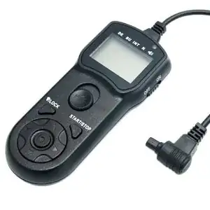

External Shutter
The shutter is very important here. You want to control your camera automatically, so that it takes a picture every x minutes, or seconds, etc. Mostly, this is done using external remote control shutters such as this – availability depends on your camera model:
