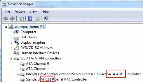

How do you know you're using IDE or AHCI? Go to Device Manager and expand the hard drive controllers. If you see "AHCI" in there, you are using AHCI.
device manager, IDE ATA/ATAPI controllers
The good news is that you can switch from IDE mode to AHCI in Windows 7 or Vista without reinstalling or even opening your PC case. Here's the MSFT KB article on how to do so.
