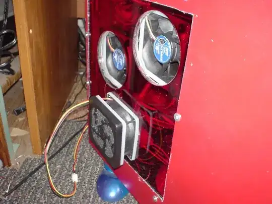

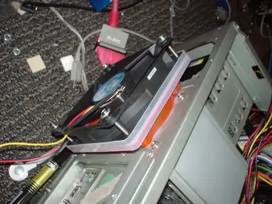

Did I mention Cut and Paste? A case is but metal and plastic in the right places. They are very malleable. Here is one cases, oddities added:
Foam fan grill
80mm foam fan grill
Bay plates
Here you can see the Bay plates, perforated and filtered.
Extra  stuffing
If you look close you can see loose items that stuff into open back ports
Fan adaptation can increase the hole sizes, which can reduce a restriction from a filter.
These pictures are from a different idea "the suck mod", of sending the main heat directly out of the case, so CPU and video card heat is not dumped into the case. With the majority heat going straight out, the amount of flow needed through the case was reduced.
