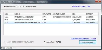

I use the Windows only freeware tool HDD Raw Copy Tool to write .vhd images to physical media.
My use case is using Windows 7 to replicate FAT32 partitions onto micro SD cards but it can support a wide range of interfaces/media types.
It has a portable version available for one-off or nomadic use, or an installer if you prefer that kind of thing.
The GUI is quite straightforward:
- Select source (drive or file)
- Select destination (drive or file)
- Copy

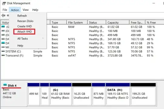

- First, attach the VHD in Disk management, so that it becomes visible as a usual disk in the system. After you attach it will be visible in console blue-colored, like this

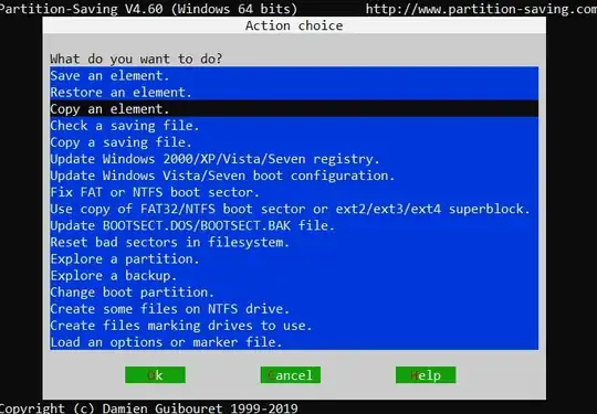

- Then close the console, and launch the savepart executable under admin account like was highlighted above and you will see the following start window
as our task is to copy VHD to disk, here we select Copy an element

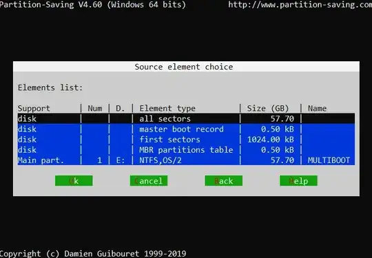

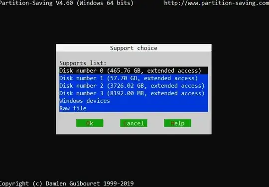

- Then it shows you the available disks in the system where you should select the source disk
As one can see, there are other types of devices there, including RAW file, so maybe VHDs are even directly can be attached to savepart, but I decided to stick to a more conservative approach and attached VHD beforehand.
- So here you select the attached VHD (remember the letter?) as source and then it suggests you to use disk sector-by-sector copy if this is one-partition-disk
or you can select a partition and it will propose to make also sector-by-sector, or only occupied space

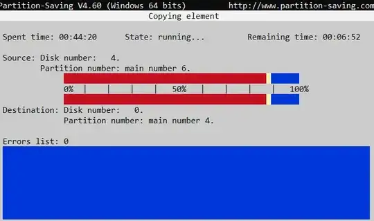

- So finally when all preparations are done you press OK several times, I used mouse bcz for some reason keyboard pressing didn't work for me in this old-school UI, and you end up in the copy process
Conclusion: copying of 167Gb partition into 300Gb target took 52m for me, but I did it from external drive and this drive had exFAT filesystem, so you numbers may be smaller.
