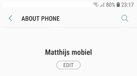

On my Galaxy Edge S7 the device friendly name can be changed under "About phone" (near the bottom of the Settings menu):
Since I configured it to "Matthijs mobiel", our local router gave me the hostname "Matthijs-mobiel.fritz.box". Unfortunately it sounds like your router might be assigning a name based on MAC address rather than based on the device friendly name, in which case this probably won't help (though you can try configuring a name that's a valid hostname already, perhaps it will work).
