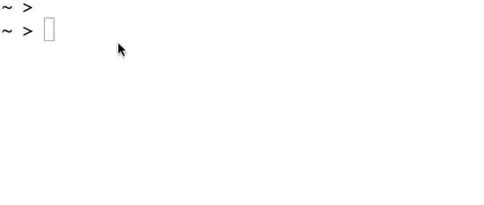

The solution is to never enter a command until the multi-line is right, just type: CtrlvCtrlj when you want to go to the next line. Metab to go back a word.
solution
credit to @rici's answer
