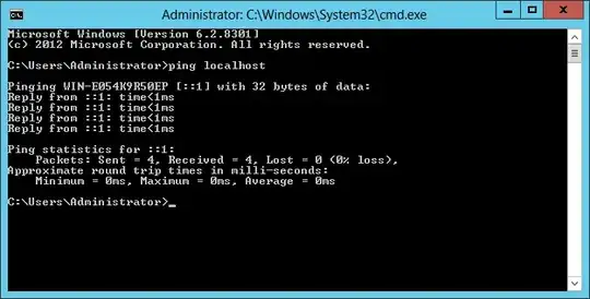

Using cmd and ping on Windows gave me the following results:
  • Pinging "localhost":
Enter image description here

Aren't both situations exactly the same?
I mean, I'm pinging the same interface, the same machine and the same address. Why do I get such different results?

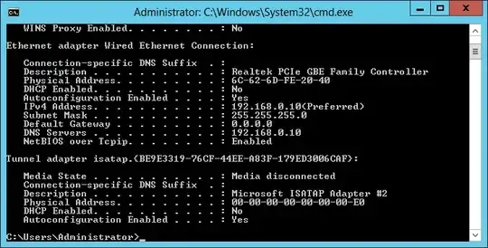

EDIT: Here is my ipconfig /all screen:

You are not pinging the same interface, without any physical interfaces you still have a "local host".
Your localhost is used to refer to your computer from its "internal" IP, not from any "external" IPs of your computer. So, the ping packets don't pass through any physical network interface; only through a virtual loop back interface which directly sends the packets from port to port without any physical hops.
You might still wonder why localhost is resolving to ::1, while traditionally we would expect it to resolve to the IPv4 address 127.0.0.1. Note that .localhost is traditionally a TLD (see RFC 2606) which points back to the loop back IP address (for IPv4, see RFC 3330, especially 127.0.0.0/8).
Looking up localhost using nslookup gives us:
nslookup localhost
Addresses:  ::1
          127.0.0.1
Thus Windows prefers to use the IPv6 loop back IP address ::1 (see RFC 2373) as it is listed first.

  • My Ethernet Adapter have no IPV6 adress configured on it. Actually IPV6 is disabled on the wired interface. – Diogo Apr 18 '12 at 19:28
    The OS appears to disagree with you. – EBGreen Apr 18 '12 at 19:28
    It doesn't matter, it's apparently set up for the computer, localhost is hitting the ipv6 loopback. – Rob Apr 18 '12 at 19:58
    @DiogoRocha There is no such address ::1 in IPV4 world. 127.0.0.1 is the IP reserved for the loopback there. ::1 however DOES exist for IPV6, and like 127.0.0.1, is reserved for IPV6 loopback. – Andy Apr 18 '12 at 20:51
  • @DiogoRocha the loopback address doesn't go through a physical interface, so as long as your OS has IPv6 enabled it can be mapped to it. In Windows for instance, the mapping is done via a config file. – Danny Apr 19 '12 at 01:18

Now, the why might be that you have Teredo set up (I can't tell from your screenshot, piping it to a text file and pasting the whole output is better) - the behaviour of localhost being IPv6 is consistent with the systems on my IPv4 only network with teredo installed, but systems without it behave as you expect it to getting 127.0.0.1 when you ping localhost. I've tested this with Windows XP and need to see what my Windows 7 systems do and update the question.
Generally, systems default to IPv6 if IPv6 is available so, your system is working as it should .
