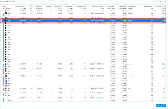

I normally have numerous windows and tabs open and looking for a tab by the sound icon is a time consuming case of 'where is waldo'.
It's not a perfect solution but using the built in 'Task Manager' and sorting by 'Idle wakeups' column helps me find the culprit much quicker.
locating tab playing music
