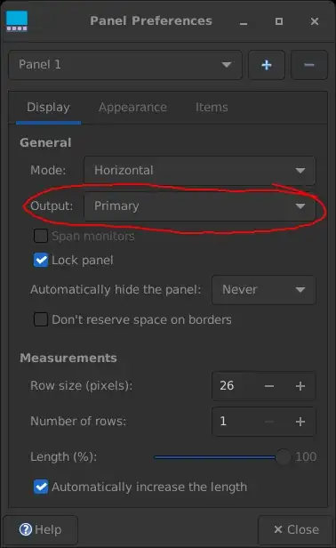

My panel did not appear on the primary display.
I fixed this by changing the "Output" option in Panel Preferences from "Automatic" to "Primary".
Xfce Panel Preferences, Output: Primary
