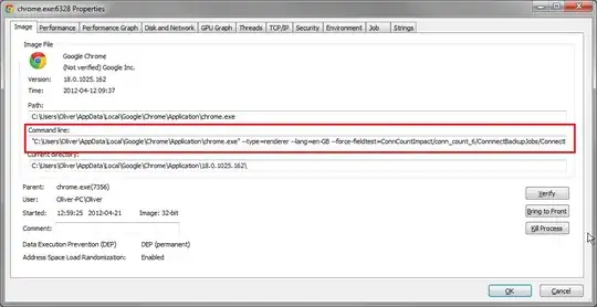

You can do that using Process Explorer.
Just hover with your mouse over a process to see the command line arguments used to start it:
Alternatively, you can open the properties of the process and inspect the command line right there:

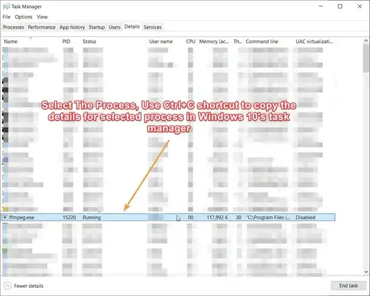

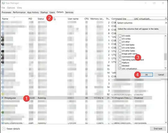

I know that OP have asked a question regarding Windows 7 and there are some great answers around.
I was facing this issue in windows 10 and I did not want to user ProcessExplorer or any utility but rather an easy way to get the command line arguments of an FFMPEG process that was initiated by a Video Converting tool. But the steps apply to any process that is run using command line arguments.
Here is what I did.
- Launch Task Manager >
- Identify Process >
- Right click the Process and click "Goto Process Details"
- Right click on any column and select "Show Columns" and then check "Command Line Arguments" option > Click OK.
- Then select the process you want the command line arguments for and then use Ctrl+C to copy all the data for that process (including the command line arguments)
Here are the screenshots for the steps.
Hope it helps someone. Best

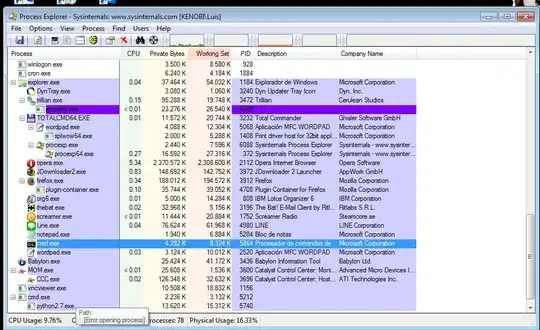

When using CygWin, if I start a Python process, this is an example of command line:
c:\CygWin\bin\python2.7.exe /usr/local/bin/sudoserver.py
But Process Explorer only sees the main exe:
(note the "path: [Error opening process message]" (see EDIT-1)).
Same results for tasklist:
C:\>tasklist | find "python" /i
python2.7.exe 5740 Console 1 15.312 KB
So, the only trick I know until now, is finding it via CygWin Bash shell pgrep:
Luis@Kenobi /cygdrive/c/
$ pgrep -f -l server.py
5740 /usr/bin/python2.7 /usr/local/bin/sudoserver.py
It is useful to know this, as long as CygWin cohabits with no problems in Windows, and you can use it to run many POSIX and Python programs.
EDIT: In Windows you don't seem to need administrator priviledges for tasklist. In CygWin you will need them to be able to view an administrator's process (what seems more logical to me: the full command-line could have some parameters like passwords inside), so we must run the CygWin Bash in elevated Administrator Mode.
EDIT-1: This problem will not happen if you run Process Explorer as administrator. Thanks you for pointing, @Pacerier.
