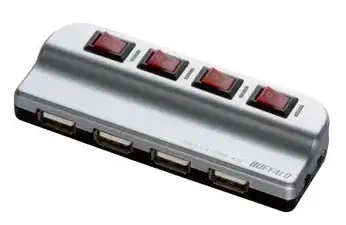

You might use a powered USB port.
For example, the Buffalo BSH4A02 USB Hub gives you maximum control:
alt text
(No idea where it's sold and for how much, though)

  • But then are we sure **this** doesn't make any light ? These buttons looks typically like being lighted up when on. – Gnoupi Sep 15 '09 at 13:00
  • @Gnoupi: You're absolutely right - that's a serious drawback. Solution: while the mouse is ON the work-table, this can be tucked underneath! – harrymc Sep 15 '09 at 13:08
  • But then it's not easy to access! And even, the light would make a glow around anyway :) – Gnoupi Sep 15 '09 at 13:13
  • I'm flat out of counter-arguments ... – harrymc Sep 15 '09 at 13:44
  • My "light" argument wasn't really one anyway. These things light up only when on, and the point of such device would be to turn off easily when not using. No light problem, then ;) – Gnoupi Sep 15 '09 at 14:10
