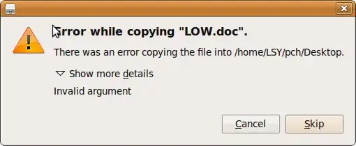

Here's a screenshot on someone's Ubuntu of the exact error I receive while trying to copy it from the custom location mount:

  • er... wait. just saw the error, so you mean you can actually connect to the share?? – caliban Sep 15 '09 at 10:56
  • I didn't have smbclient or smbfs when that happened, it was using some sort of default network connector application to try to connect to the smb. Then it was giving that, and someone said try smbclient. – meder omuraliev Sep 15 '09 at 11:15
