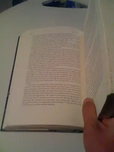

I came across this on Lifehacker quite some time back, and it has been one of my top DIY projects ever since.
Replace the iPhone with any camera or imaging, and you get a stack of nice high-res jpegs ready for you to OCR with any software, even (urks!) MS Office... ;)
Cheap. Effective. DIY. You can't beat an idea like this.
EDIT: Comments raised up some points about shadows, page curlings, etc. Quite easily resolved for anyone who have literally photo-copied library texts.
Add a multiple light sources to illuminate the book, and eliminate the shadows.
slant the book at 90 degrees to the pages don't curl towards the bindings in the middle. It also preserves the binding.
I'll see if I can give an example and set one up myself.
EDIT 2 : uploaded sample of how you should hold the book, and also notice the light source from the left.

  • add multiple light sources to illuminate the book, and eliminate the shadows. slant the book at 90 degrees so the pages don't curl towards the bindings in the middle. It's simple common sense, we do that all the time back in college taking photos of library texts. – caliban Sep 15 '09 at 13:34

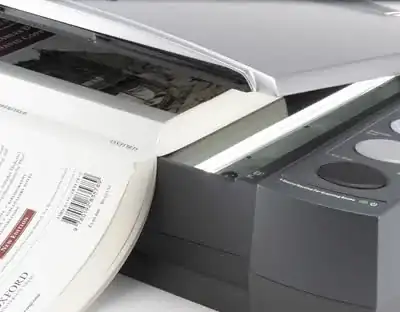

At work we use a Plustek Optibook 3600 book scanner which is about $250.
It's basically a standard flat bed scanner but with the glass plate going right to the edge of the scanner so that the book page can be placed flat on the plate. This eliminates the spine shadow and avoids damaging books.
pelms
  • 9,251
  • 58
  • 77
  • Have you ever tried using that with a really thick book? It's like 3 inches thick. –  Sep 15 '09 at 22:30
  • If you can open it 90° with the page reasonably flat it should be fine. Try on a table edge. – pelms Sep 16 '09 at 08:33
