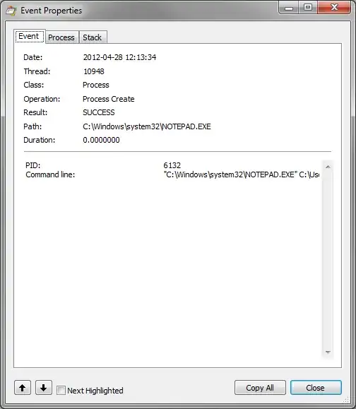

It's a long road from the point where you double-click on an icon on screen to the point where an application is started.
There is a lot go wrong.
  1. You click on a file.
  2. Windows determines the file type.
  3. Can this file be executed on its own, or does it require another application to open it?
    Let's check what the registry says about the file extension.
  4. Registry says it's a txtfile.
  5. Registry says, to open a txtfile we should use a program called C:\Windows\system32\NOTEPAD.EXE
  6. Now we can finally create our process: Process Create Event captures in Process Monitor
There is so much stuff involved, there is no way of telling what exactly is the problem. You need to perform further investigations yourself.
