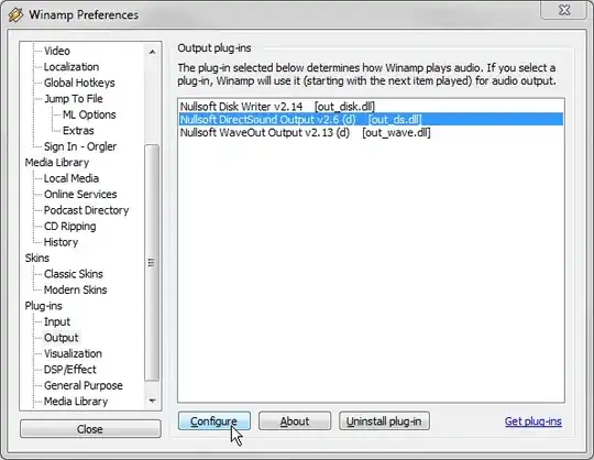

The app-specific volume set in that panel should be equal to the volume set in Winamp itself.
Just set Winamp to maximum volume and control the main volume from then on. You might find it helpful to completely disable Winamps own volume adjustment.
  1. Open the Winamp Preferences, go to Plugins and select the Output category.
  2. Select the Nullsoft DirectSound Output plugin and click Configure.
  3. On the Other tab, uncheck Enable volume control and click OK.
