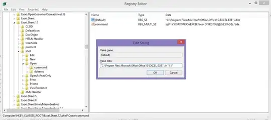

I was getting this same error with Excel. I was able to fix this by changing the Open Excel command to bypass DDE in Registry Editor:
Excel DDE Error Fix
A similar fix should work for the Open command for Word, Access, PowerPoint, etc.

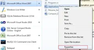

I don't use Access, but I recently started encountering the same problem with Excel and Word (2007) on Win7 while opening documents from the "Recent" list in my Start menu (using the arrow on the Word Shortcut menu item). The DDE checkbox solution didn't apply to me, as it was already unchecked (and doesn't exist in Word, as far as I know).
I stumbled upon a solution that seems to have fixed the problem for me: When I opened the Properties dialog for the document shortcut (from the context menu; see screenshot below), I noticed that the "Opens With" field had somehow been changed to another application other than Microsoft Word. Clicking the "Change" button enabled me to re-associate this file with "Microsoft Office Word" (without having to mess with the registry).
