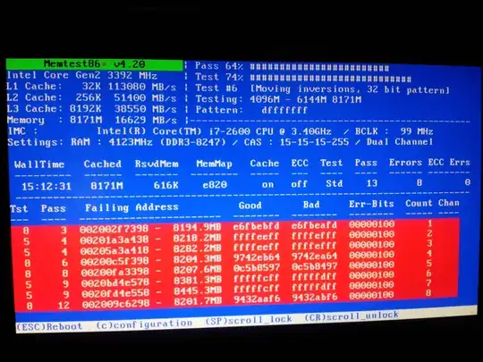

On the first run, somewhere over 12 hours, I got the following results:
Photo of results
Click for full size
There's a few irregularities. Firstly, I have 2x 4GB DDR3-1333 modules in DIMM1 and DIMM3, dual channel. This is reporting DDR3-8247, whatever that is. Secondly, all the failing addresses are outside my total RAM capacity. That's not all that much help when trying to figure out which module may be failing. Evidently, at least one is failing.

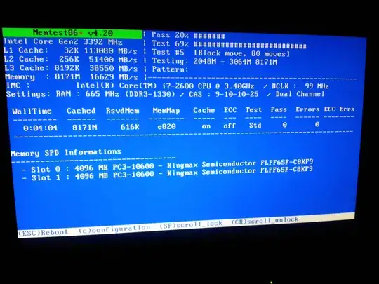

I reseated the modules and tried again:
Photo of results
Click for full size
As you can see, the frequencies and latencies are completely different. The latency values are much closer to what I vaguely recall seeing in CPU-Z (or was that HWiNFO32?). This test has only just started, so it's entirely possible those values changed sometime during the test.

My main question remains: Why is the failing addresses higher than my capacity?

  • Random stab: Your video memory is mapped into the range of memory Memtest will test. – ta.speot.is May 02 '12 at 07:02
  • My second run (after reseating) has just cropped up its first error on pass 0 test 8... at `8196.1MB`. 8GB should only be `8192MB` at most. There's no indication anywhere on the screen of video memory, and the listed memory size is `8171M`. Though if it is the video memory failing, that would explain the video hardware acceleration crashes. – Bob May 02 '12 at 07:07
  • The video memory can't possibly be mapped above 4GB -- how would a 32-bit operating system ever access it? (Theoretically, a 64-bit operating system could have mapped it there, but clearly he's not running one at this time and hasn't since he booted.) – David Schwartz May 02 '12 at 07:49
Some hardware devices need memory space with physical addresses below 4GB for 32-bit DMA. So a large chunk of address space under 4GB is reserved for those mappings. The RAM that would normally land in that space is remapped at the current end of physical memory.
I suspect heat may well be an issue.

  • So, I can't be certain which physical module that area falls under? I watched the end of test #8, it does an extra `8192M - 9208M` block. That's quite a lot of reserved/remapped space. On the topic of overheating, the modules feel very slightly warm to the touch. – Bob May 02 '12 at 09:53
  • 1GB is typical. It's free, and having lots of space can improve the performance of devices that like lots of memory mappings, like graphics cards. I don't know of any way to tell which module it is. You can try removing one and re-testing. If it was heat, I'd think they would feel very hot, not just warm. (If you're pretty sure it's not heat, you can try raising the RAM voltage a touch. You can also manually increase the latencies.) – David Schwartz May 02 '12 at 09:55
