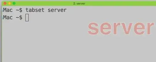

I used solutions similar to the above for quite a while, but I use enough tabs that I also want them color-coded for easy visual reference. So I whipped up tabset, a utility to set the tab title, badge, and color based on the kind of work I am doing in each tab.
example
It requires node, but that is now a commonly installed platform. To install:
npm install -g iterm2-tab-set
Jonathan Eunice

  • This is awesome! I especially love the auto setting of the tab color. Thank you! – Ashutosh Jindal Jun 11 '18 at 14:22
    Wow! This is a great tool! – dmulvi Apr 05 '19 at 18:00
  • I currently use this method instead of the one described in the accepted answer (CmdI, type something, and hit ESC) – qazwsx Jul 24 '19 at 18:52
    Yes, serious. Developers and DevOps people—these days, the natural target audience of terminal applications—have node.js installed. Or can install it easily. Those who don't/can't are welcome to fall back to bash/zsh/etc.-based approaches. – Jonathan Eunice Aug 14 '19 at 06:19
  • tabset works great, thanks for making it! this is a gamechanger for my workflow since I'm jumping between contexts so much – subelsky Jan 23 '20 at 17:45
    Unfortunately, `title` option doesn't seem to work with latest iTerm2. Little or no response to issues. If all you want is the color option, then go for it. – JESii Mar 14 '20 at 14:19
  • Latest versions of iTerm2, perhaps based on changes in macOS, no longer work as they once did. I occasionally check on the iTerm2 project hoping they've fixed or worked around the breakage, but so far, no joy. – Jonathan Eunice Mar 16 '20 at 15:00
  • This is the best solution. Simple straight forward and works on any shell. Love it – Krishna Vedula Dec 16 '21 at 04:51
  • iTerm2 3.4.15: I get the transparent text on the right but don't get the same title on the tab itself (at the top). – jcollum Apr 27 '22 at 16:22
  • It's great to set the color of the tab, but the text overlay is really slow. – Martin Braun Jan 23 '23 at 22:10
