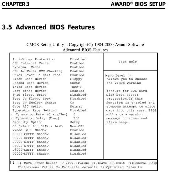

I have read the accepted answer by @Breakthrough but I think it's wrong. Or at least for the hardware I have here it does not apply (Mainboard MSI MS-6340). In the answer by @Breakthrough he says booting is by partition. So you can have one disk with many bootable partitions. But in the BIOS of my mainboard I can only select disks. Not partitions.
boot devices
As you can see on the screenshot of the manual you can say "Third Boot device is HDD-0".
Booting is by disk and not by partition as said by @Breakthrough.
The partition table of the MBR is completely ignored by the BIOS.
This matches the description at osdev.org.
So instead the BIOS only looks at the last two bytes of the MBR and sees if they match 0x55 0xAA. Then it loads the MBR and executes the bootstrap at the very beginning.
The partition table in the MBR is only used by the Windows OS and not by the BIOS.
Also note if you format a disk (for example an USB pen drive) with FAT32 then it will have a MBR! Although it is not bootable! Don't ask me what the MBR bootstrap code of this disk will do. It probably simply aborts and goes to the next boot option.
