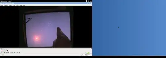

  • My problem + others problem with this is that, when i touch-over (mouse-over) the touchscreen, the mouse cursor do not follow my (finger/touch) movement. On press the cursor press (click) in the wrong location.
My goal is to fix it, so that the press location is exact.
