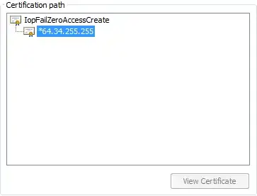

So now what I tried to look is where is the problem and I found something very suspesion
I looked at the certification path from Chrome browser of each page that actually have HTTPS and they look very similar
like an example of https://google.com
And here is from https://facebook.com
And here is from https://stackoverflow.com
It doesn't seem right to me when I see most of them is like *.*.255.255 ips which is unlikely to be correct because as I remember once when I have problem about time is not match I will see the actual name site from facebook including there.

    It definitely looks like something is attempting to man-in-the-middle your https connections - if malicious, in an attempt to harvest passwords. If not malicious, then perhaps a proxy server is involved. In any case, do not attempt to login to any sites using this machine until you get an answer. – Paul May 06 '12 at 14:32
  • I'm very confuse now why is this happening, but the most confusion thing for me is that it's only happen to Chrome :( – Ali May 06 '12 at 14:34
    I am no chrome user, but have you tried disabling all addons? (if there are any) – Baarn May 06 '12 at 14:44
  • @WalterMaier-Murdnelch This is now a new Google Chrome installed [I did clean uninstall] and still happening :( – Ali May 06 '12 at 14:46
  • The IP addresses end in *.*.255.255 so that they cover the entire range of associated IP addresses. Malware is definitely hijacking the connection and inserting a fake HTTPS header, so **do not** log into any websites on your computer until this is fixed. Check any addons for Chrome, check for viruses. Does this same problem happen with Firefox/Internet Explorer? – Breakthrough May 06 '12 at 14:55
  • @Breakthrough No it is only happen with Chrome. I've clean uninstall Chrome and reinstall without having any add-ons and still happening. – Ali May 06 '12 at 14:57
  • @Ali if you can, scan your computer using [Spybot S&D](http://www.safer-networking.org/index2.html) and [Microsoft Security Essentials](http://windows.microsoft.com/mse). What do you mean when you say "it also happen on Firefox about the new tab ads"? – Breakthrough May 06 '12 at 15:01
  • @Breakthrough I'm going to check from both program use asked for. For the ads I just update my question new tab come up without even knowing from where. – Ali May 06 '12 at 15:06
    @Ali you definitely have malware. I would change your passwords from another, secure computer as soon as possible. Scan the computer ASAP, and if nothing is found, you might want to take the HDD out and scan it from another computer. – Breakthrough May 06 '12 at 15:12

It is very likely that your system and/or connection is compromised and someone is intercepting your internet communication.
Searching for IopFailZeroAccessCreate on Google only brings up people complaining about computer problems.
I found some good instructions on 2-viruses which may or may not relate to this specific issue. The article seems to deal with a different kind of infection, but the same solution should apply.
  1. Check your hosts file for malicious entries. Hosts file resides on C:\Windows\System32\Drivers\etc\hosts
  2. Check DNS (Domain Name Server) settings
  3. Checking your proxy settings on Internet Explorer
    Chrome also uses these proxy settings!
  4. (Optional) Check your proxy settings on Mozilla Firefox
  5. Check your IE add-ons
  6. Scan for malicious parasites with spyware/antivirus removers
  7. (Optional) Repair Winsock 2 settings with LSPFix
