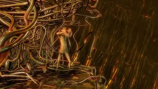

Taking an example from Wikipedia's article on motion compensation, let's say this is your original frame:

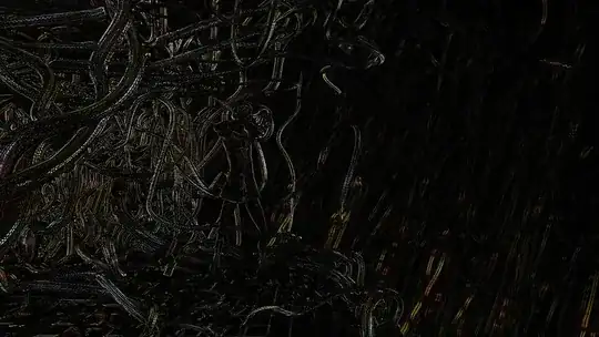

Then the difference to the next frame is just this:
The encoder now only stores the actual differences, not the pixel-by-pixel values. This is why the bits used for each frame are not the same every time. These "difference" frames depend on a fully encoded frame, and this is why there are at least two types of frames for modern codecs:
