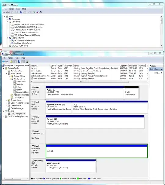

I have a SanDisk Cruzer Micro 4gb that I use often. Today, after using it to install ubuntu on another pc and plugging it to my main computer, windows 7 refuses to mount it (IE the drive does not appear in "my computer").
The volume DOES appear in the disk manager and device manager ("Disk 4"):
but when I try to assign a drive letter (via right click > change drive letters and path) I get "The system cannot find the file specified"
The really weird thing is that if I disable and re-enable the driver in the device manager, suddenly everything works and the flash drive gets assigned a letter and shows up in "my computer" (The letter J: in this case). I can even change the drive letter now without the error, but this does not remedy the problem.
Even so the next time I unplug and replug the device it reverts to it usual annoying self and does not get mounted (doesn't get a drive letter or appear on "my computer")

Have you tried reformatting the usb drive. I noticed that in the disk management utility it labeled your drive as a (Logical Drive) as opposed to a active, primary partition. I just tried it with a spare usb drive and after a standard format for me I got:
I also heard somewhere that some logical drives have conflicts when assigning letters. It might have only been with networked drives though.

  • Yes I have. If I try to format it when it's unmounted (by right clicking in disk management and choosing format) I get the same "system cannot find file specified" If I do it after disabling/enabling it formats just fine, but the problem resides. It still shows as "logical" rather than "active, primary" when unplugging, replugging and disabling/enabling – OpherV May 08 '12 at 11:07
