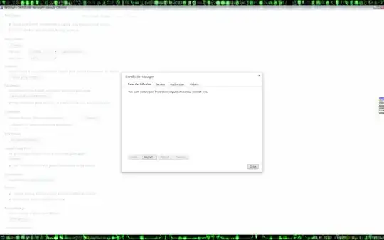

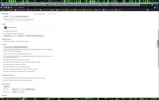

1. Disable hyperlink auditing
Screenshot
(Click images to enlarge)
2. & 3. Clear your cache as this CAN actually slow down initial download connecting - since it looks for previous metadata FIRST.
(In Settings -> Clear browsing data... -> select any non-defaults as suits you.)
Screenshot
Screenshot
4. Check for bad/old/suspicious certificates (malware, etc. can be injected via certificates being implanted and sites being redirected ---cert pinning only helps if these are not system trust certs (for list of valid/common ones your search engine of choice should return a healthy list)
(In Settings -> Manage Certificates -- you must click Show advanced settings first to see it)
Screenshot
