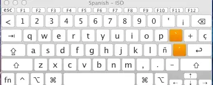

Layout Mac thinks my keyboard is:
My Spanish ISO layout

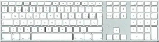

Expected Spanish ISO layout:
As you can see from the images - the layouts are different. For example, '<' and '>' are in different locations.
Any idea how to fix this?

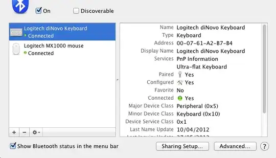

Additional Information I am using a Macbook Pro Mid 2009. OS - Lion - OS X 10.7.3. It does have a built-in keyboard, but thats the UK keyboard. External Spanish Keyboard is a Logitech wireless DiNovo http://www.dvhardware.net/article6438.html. I do not have any more external keyboards.
Keyboard Prefs: Keyboard Prefs
Bluetooth Settings

  • [This is what I get](http://i.stack.imgur.com/vrLSE.png) for Spanish ISO, when connecting a full sized keyboard. This is for a [small sized](http://i.stack.imgur.com/du4jv.png) (MacBook) keyboard. It's weird that your Spanish ISO looks different. Have you ever modified keyboard layouts? Running OS X Lion, correct? – slhck May 15 '12 at 12:00

  • You have 2 keyboards connected to your Mac Book, then: the internal one and the external Bluetooth one. Keyboard viewer only shows the keyboard layout for whichever keyboard you last pressed a key on. So your screen shot of the keyboard viewer is displaying the the layout of your built-in keyboard, which is correct. Please double-check and show the Keyboard Viewer screenshot immediately after pressing the space bar on the Logitech keyboard. – Old Pro May 27 '12 at 22:22
  • the keyboard viewer posted is taken after pressing space bar on the Logitech keyboard. If I press space bar on the internal keyboard, a different layout appears - the one I am aiming to get for the logitech keyboard! I have tried disconnecting, and reconnecting the Logitech keyboard, not sure what else is needed. I do remember, however, on the previous OS version when I used to connect the keyboard, I was asked to press the key next to the left shift button. I think it detected the keyboard based on that. I do not know where to find the same dialog box in lion. – Newton May 27 '12 at 22:53
  • The dialog box you are looking for comes up when you click on Change Keyboard Type. Apparently under Lion that button disappears if the Mac is "sure" about the attached keyboards. I've tried running keyboard setup manually in this situation, but it just quits claiming there are no unknown keyboards. You definitely have something messed up if the keyboard viewer is showing the opposite keyboard. – Old Pro May 28 '12 at 18:31

It appears the Mac thinks you have an ANSI keyboard when you actually have an Extended ISO keyboard. The layout you show as being active is the layout I see when I set my Mac Book Pro to Spanish ISO using the built-in ANSI keyboard. Probably you skipped Keyboard Setup when you installed Lion or you pressed the wrong buttons or something. In any case, it should be fixed by re-running Keyboard Setup.
  1. Choose Apple menu > System Preferences, and then click Keyboard.
  2. Click Change Keyboard Type.
  3. Follow the onscreen instructions when Keyboard Setup Assistant appears.
If the "Change Keyboard Type" button does not appear, then as a last resort you can try deleting the /Library/Preferences/com.apple.keyboardtype.plist file. First, turn off your Bluetooth keyboard, then delete it from the Bluetooth preferences, then delete the file, then reboot, then re-pair your keyboard. This should automatically bring up the Keyboard Setup Assistant.
