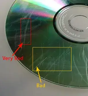

1.yes but not completely
It will depend on how much it is scratched . If it is negligible just ignore it . If it is in the moderate level some utility programs may help you . If it is in very high level no hope , (still you may can recover some data if you have luck :) )

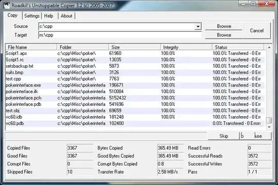

  2. Roadkil's Unstoppable Copier
    Recovers files from disks with physical damage. Allows you to copy files from disks with problems such as bad sectors, scratches or that just give errors when reading data. The program will attempt to recover every readable piece of a file and put the pieces together. Using this method most types of files can be made useable even if some parts of the file were not recoverable in the end.
Or Try to fix the DVD
  • First clean the surface of the disc with a soft lint-free cloth. You can use a gentle detergent (or rubbing alcohol) if there are some grease spots. Make sure there are no finger prints or dust particles. Don’t scrub too hard as you may do more harm than good this way.
  • Now apply some toothpaste or polish on the scratched surface. It is best to start with a minimum amount of either, or else you will have your work really cut out trying to buff away the remainder.
  • Now rub gently with a cloth moving from the center outwards.

    +1 for Unstoppable Copier, that software is fantastic for grabbing data off bad/dying drives as well. – Evan Wondrasek May 29 '12 at 14:21
    Yeah, the important thing, when trying to remove scratches, is to NOT do circular motions, which will tend to put new microscratches parallel to the recording tracks but instead use radial (in-out) motions. And likely a Radio Shack or Best Buy near you has a kit for scratch removal. – Daniel R Hicks Oct 10 '13 at 23:41
