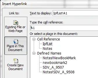

It can be done...
Assuming you have your excel file open, open a Word document. Type the text that you want to link to. (you will copy and paste this text into a cell in your excel file.)
After generating your desired text in the word document:
  1. Select the text (portion) you want to link to.
  2. On the Insert tab, in the Links group, click Bookmark.
  3. Under the bookmark name type a name for your Bookmark such as a topic name. (no spaces but underscores allowed.)
  4. Click Add
  5. Copy all of the text from the word document and paste it into your excel document (cell).
  6. Select the cell where you want to create a link to this new text
  7. Click Hyperlink
  8. On the left hand menu select "Place in this document"
  9. In the window to the right, you will see your Bookmark under "Defined Names"
This will take you to the text in the cell that you pasted.
Updated. You can rename the Link in the top "Text to Display" Entry.
