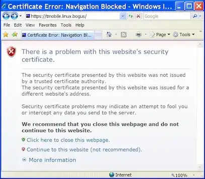

However, I don't believe CAcert.org's root certificate is included in most browsers by default. Your visitors will need to install this root certificate or else they'll get the Scary Certificate Warning:
Untrusted certificate error
Option 3: Generate a self-signed certificate
If you really cannot purchase a certificate, you can create a self-signed certificate. This doesn't require any CA, but others computers will not automatically trust your certificate. Guests visiting a website secured by a self-signed certificate will receive the Scary Certificate Warning.
