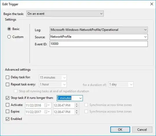

Once you get that working, make a scheduled task triggered by event id 10000 in source NetworkProfile of log Microsoft-Windows-NetworkProfile/Operational which calls it:
Task Scheduler trigger example
Personally, I bundle that with iexpress.exe to run it hidden in the background and make sure the scheduled task is set to run even if I'm not logged on. I just set this up on my computer a few weeks ago and it's been working great!
