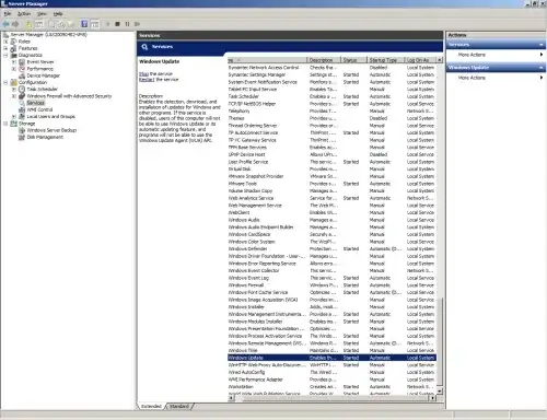

This morning I attempted to run Windows Update on two of my Windows 7 PCs (both are virtual machines), and I ran into this interesting pop-up error message. I have never encountered this problem before, so I was somewhat perplexed.
From the message, my first thought was to see if the Windows Update service was running. It was. As usual, the solution is never so simple. I attempted to restart the service and reboot the PCs to no avail.
So, I am off to the interwebs for a solution. I did find a solution to the problem, so I thought to post it for my future reference and for anyone else who may encounter this problem. I will be posting the answer shortly.
If you have alternate solutions that have worked for you, please feel free to leave a post or comment.

Apparently, the problem is with a corrupted windows log file.
In order to get Window Update running again, you have to:
  1. Go to Services, and temporarily Stop the "Windows Update" service
  2. Go to c:\windows\softwaredistribution\datastore\logs\
  3. Find the file edb.log
  4. Rename or delete the file
  5. Once the file is renamed or deleted, go back to Services, and Start the "Windows Update" service
  6. Try to run Windows Update again. It will work normally.
So far, I have not had any problems with this solution. I have successfully installed updates on one of the PCs.
