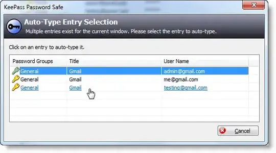

May be there is a problem with your entry which you have made recently. So I'm going to answer you from start. Create a new entry and make sure that you have give the right title name Gmail. After this enter your username and password for you Gmail account.
Also you should have to enter the right URL of the login page but you can keep it blank also.
Now your entry looks like this
Now there could be a problem with the Global Key as Ctrl+Alt+A you can change it through the Tools>Option and then click on Integration tab and change the Global auto type to some other key combination. As when I pressed those combination it launched the other program associated with it.
But you already tell that its worked on other sites not only these two. Above method is working on my PC without any problem so may be it was your problem. Give it a try. Good luck!

  • It worked! Thanks! "Wrong" title! But does it really depend on the title of the website (window name list)? I have made it work with both Google Mail and Hotmail. But for example on the log in page for Hotmail it sometimes says "Welcome to Windows Live" and sometimes "Välkommen till Windows Live" (Swedish), and if you log out of Hotmail and want to log back in the title changes to "Sign In". This makes it almost impossible to use KeePass and auto-type unless you edit the entry in KeePass for every time it does that. – Samir Jun 07 '12 at 11:31
  • AFAI think the title is not on the page its shows on the tab when you load any page. For solve to this puzzle you can set any name of **title** but then you have to make notes. See this [article](http://www.howtos.ca/2010/01/advance-usage-of-keepass.html). – avirk Jun 07 '12 at 13:04
  • Thanks! That article was actually very helpful. The title of a given web-page or a web-site is shown both in the title bar of the program window and in the tab button (assuming it is a tabbed web browser). This is true for Firefox, Chrome and IE. – Samir Jun 07 '12 at 14:15
  • FF, chrome, opera, IE and safari all are tab browsers. Because this is not the matters that the title s showing in tab **Keepass** check it form the page where they coded the page and set the title whatever of the page. – avirk Jun 07 '12 at 14:19
  • I'm not sure I understand you correctly. Are you saying that KeePass checks the title of the HTML, like so: `HTML 4 page title like "Email from Google"document content` Is it the `` tag it checks for? Is that what you mean? – Samir Jun 07 '12 at 15:33
  • Yes I mean that, but I'm not much sure its my guess. – avirk Jun 07 '12 at 16:20
