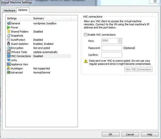

There is a built-in VNC service in Workstation. I've not used it, but the config (below) would seem to suggest that you could enable it, and use your host's IP with a particular port with any of a number of VNC clients to gain control of your virtual machine.
VMWare Workstation VNC Config Setup
