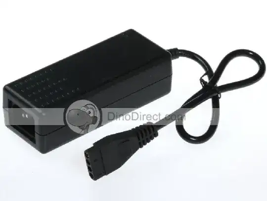

If you did want 12cm, you could power it from the mains/acdc.
For example any USB-SATA/USB-IDE adaptor comes with a plug with something like a 4 pin molex or similar,like a sata power connector. So, either way, with 12V, and the fan can connect to that whole plug, it may need an adaptor but they're easy to get.

  • Thats a *really* odd adaptor - what would it be practically used for, other than powering fans? – Journeyman Geek Jun 08 '12 at 09:51
  • it blows air in or sucks air out(probably sucks for that device). it cools a laptop. The fan is in it. Just the little fan inside it. That area it is adjacent to is the vent of the laptop. Infact I dreamt such a thing up and then found it existed..thouh i'd want one that took a 12cm fan like the questioner, though i'd want 12cm 'cos they can be a bit quieter while pushing the same amount of air. I found that when I blew reasonably cool air into the vent of my laptop from my mouth, it cooled it down. So a device of that structure is only natural and could be built as a DIY task. – barlop Jun 08 '12 at 15:29
  • I don't know for sure what that round thing in the middle of the USB cable is, it's not relevant to the cooling and it's probably just a retractable usb cable type thing – barlop Jun 08 '12 at 15:33
  • @JourneymanGeek I suppose these things are useful if your laptop doesn't cool itself sufficiently. Or, if its own fan goes up when the cpu temp reaches a certain level, but it goes on too loudly. It can give more control over things in some ways, when the cooling is external. – barlop Jun 08 '12 at 15:59
  • No, the other one , the one that looks like a laptop charger ending with a mplex connector – Journeyman Geek Jun 08 '12 at 17:10
  • @JourneymanGeek that one , ACDC adaptor with an mplex connector, is taken from a USB-IDE/USB-SATA adaptor kit. Such an adaptor kit is a must have, as plugging an internal drive in externally was last time I checked, cheaper than an external drive, and also great for a techie to have e.g. to quickly see what's on a drive. One could use it to power a fan or any device though. One time i wanted to know how many watts a cd drive used(not relying on the label), so I plugged a mains power meter into the wall, and that ACDC adaptor into it, and then plugged the cd drive into that. – barlop Jun 08 '12 at 18:24
