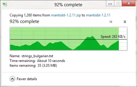

The obvious reason is that the speed of the transfer varies over time, and so does the average, and so does prediction. To explain this to a non-tech friend, I've used an analogy involving travel by air. You're going to fly over the Atlantic. When you arrive with a taxi at the departing airport, your ETA is about two months. When you disembark at the arriving airport, based on your average speed so far, you will reach your friend's house in 5 seconds.
But you need to appreciate how much the speed can actually vary, even with what seems like a predictable scenario, like copying files within the same disk, or between two local disks. One of the new features I like in Windows 8 is the ability to graph the speed over time if you click "more details". If you don't have access to a Windows 8 machine, search images for Windows 8 copy dialog for a lot of examples. Many of them are fairly flat, but many of them are also disturbingly bumpy, to the point that you wonder whether the hard drive is actually healthy, when it dips to zero.
Some of these bumps are likely due to variations in file size—smaller fields yield more accesses, which slows things down, especially on a mechanical hard drive which has to seek by moving its read head—but some it might just be a cheap drive which stalls on the slightest touch to prevent damage to the platters.
There are better and worse ETA prediction algorithms, but for an accurate prediction, the computer would have to be all-knowing. The risk of trying to make the algorithm "smart" is that it might create new, unforeseen, cases where it's even more hilariously wrong.
Windows 8 copy dialog 2
nitro2k01
  • 2,411

In short, the calculation is based on the current transfer speed.
For example: If your transfer rate sinks because windows has to copy huge amount of tiny files, the expected time goes up linearly and vice versa for large files.
It is nearly impossible to predict what the transfer speed will be over the whole transfer process, because it depends on a lot of factors like filesize, CPU usage, transmission erros etc.

I just copied 200GB from USB HDD to my main drive. There were about 130000 files
After the first 4-5 minutes I observed that:
  • For the smallest files, the rate was about 100 files per second at about 600KB/s
  • And for big files it was like 70MB/s
At beginning windows changed the estimation from like 1 hour to 5+ hours then back to 1 hour and so on. At the end like in 95% it was still changing the estimation from 10 minutes to 10+ hours. So it instead of become more accurate it was going less and less precise.
Simple math shows:
130,000 files at 100 files per sec = 22 minutes
200,000 MB at 70 MB per sec = 47 minutes
22 minutes - loosed in seek time copying files of few kilobytes in size. 47 minutes - the time it will need to transfer the actual data if there is no seek time.
Sum of the 22min + 47min is the absolute maximum time that it could possibly take.
So obviously the estimate should be somewhere between 47 and 69 minutes.
What the dialog shows at about 90%: "I am copying some small files at 1MB/s, there is 20GB more data, it will take 5:30 hours to complete.
Few seconds later: "I am copying a big file here, at 70mb/s it will take 4 minutes to complete.
What human actually sees from the same dialog: 120,000 files and 180GB are already copied for 40 minutes. The rest 10000 files and 20GB should take about 5min
The dialog gives enough information to make calculation that gets more and more accurate each second. It knows rate at which small files are copied. It knows at what speed big files are copied. It also knows how many files and how many bytes there are left.
It is so simple to make so accurate assumption only by setting the upper and lower limit.
The dialog shows a bit more correct data only in case when the big files are before the small files. If this is the case it starts at 40 minutes, and after 30 minutes it starts copying small files and says "well I need 20 minutes more".
But when the small files at the beginning and big files are at the end. The dialog does not actually care at what "files per second" it transfers the small files. It make its calculation like the small files count is infinity, and that like they will forever be small.
