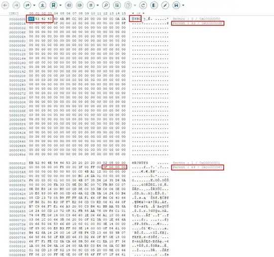

  • I've looked around a bit more, and found out what is the USBC marker: it's a header from SCSI-over-USB protocol. There's not much to be said more, but you may want to read: http://quetzalcoatl-pl.blogspot.com/2013/06/adata-nh92-recurring-malfunction.html – quetzalcoatl Jun 25 '13 at 12:03
It's not a virus. The sector with the USBC string is actually containing a USB command block and can be decoded as such. For some reason controller wrote the command block to the drive. To me it sounds like a bug in certain controllers.
USBC sector
We see 'USBC' sector at LBA 63, this is original location of the boot block. In next sector we see actual boot block which "thinks" if we decode it, lives in LBA 63 (0x3F).
IOW the boot block shifted one sector 'down' while the USBC sector was inserted. All sector following the bootblock also shifted one sector and final sector from 16 sector block was 'dropped'.
We can 'decode' the USB command block:
USB command block structure
In my sector dump above it would read something like: “write 16 (10h) sectors starting with LBA 63 (3Fh)” (2Ah is write command)."
We can partially repair by patching the 16 sector block, but we need to be aware of the fact that 16th sector what was intended to be written to drive is lost as it was dropped.
To patch we delete the first of the 16 sectors, fill last sector with zeros and write back to disk. In this video I patched several instances of USBC sectors on an SD Card (disk image file) to allow for file recovery including filenames + folder structure: https://youtu.be/xfhu96N5JR4. Note that these sectors were written on the SD Card, IOW it was not an issue with my card reader.
