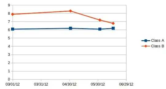

I have an area chart in LibreOffice Calc where I would like the X axis to be measured in one month intervals spaced evenly apart.
The data going into the graph, however, is not regularly spaced at one month. There can be zero, one, or two entries in any given month.
Right now, the chart is keeping the horizontal pacing of the data consistent and adjusting the X axis to accomodate, which is the reverse of what I want. In the example picture below, you can see that there is one data point in March, one in May, and two in June. Along the X axis, April is gone and June is taking up double the space.
chart example
Instead of this, I'd like the months to stay the same spacing so there is April, May, and June, and for the data area of the chart to compress or extend horiozontally as necessary. I have tried editing the X axis and adjusting the time intervals, but this doesn't seem to do anything.

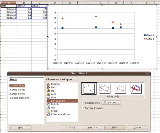

Yes, this is possible. You need to select the XY (Scatter)chart type. If you start with this data table:
data table
..., select it, start the chart wizard and select XY (Scatter), the result preview already shows that the data points are córrectly spaced:
chart wizard
(NB: i didn't customize the wizard's defaults yet - Calc did recognize the columns correctly).
The only problem is that you still can't tell Calc to use "one month" as scaling unit for the X axis. This means, the scale of the X axis will use days as scaling unit. If you set the major interval of the X axis to 30 (days), the resulting chart will look like this:
