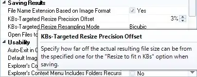

In spite of being a late response, hopefully my answer will benefit some.
You can do exactly what you want with Batch Images: http://www.binarymark.com/products/batchimages/default.aspx
Step 1: Add images however you want (all files in folder, by searching for specific files, etc.) Add images
Step 2: Actually called step 3 in the program is where you specify the desired out file names, image file format, and most importantly target file size (which is what you want): Output settings
As you can see there is a "Resize to fit" option (under File size) where you specify the file size. Under advanced options the program offers additional tweaks: additional options
Here you can specify how close you want the size to be matched (it cannot be exactly the size you specify to the byte, because of image format limitations and other reasons that have to do with information compression). You can also specify resampling algorithm used which affects quality / sharpness at the expense of the resulting dimensions: the sharper the image the more bytes it needs per given number of pixels, but because the final file size is constrained, it ultimately results in image being shrunk dimension-wise even more.
Disclaimer: I am using a paid version of this product, and have actually used this feature on many occasions, and most of the time the results are very closed to the specified file size.
