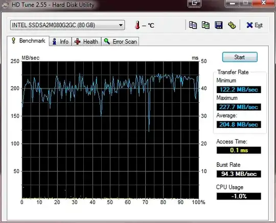

I use HD Tune to measure performance of the hard drive. The tests typically take 2-3 minutes and the transfer rate of a regular hard drive decreases dramatically as the test comes to a close.
However, the SSD drive performance stays the same over (pic below) the life of the test. This happens on all my computers. Why is that?

    It may be be good to know what the test is actually doing behind the scenes. – jmreicha Jun 22 '12 at 18:27
    ... and what the graphs represent. The (read) transfer rate (as indicated by the blue line) is not as significant to the (total) *access time* as the (average) rotational latency and (typical) seek time of a HDD. The shape of that blue line is not a performance indicator. – sawdust Jun 22 '12 at 22:22
  • i have four ssd in raid 0 (keep backups of course). I'm getting around 650-700 Mb/s. HDTune is a nice piece of software. – ctilley79 Jun 23 '12 at 00:39
    I think the title is misleading. Isn't it true that hard drives maintain performance over time but solid states degrade because of some physical degradation from too many writes? – mowwwalker Jun 23 '12 at 03:49

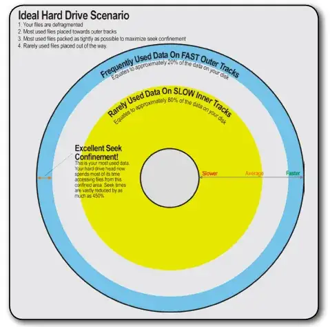

Actually what you are seeing on the X axis does not correspond to the "time", but to the "physical area" of your disk. I mean, if your disk has 250GB (100% of it's capacity), the 0-10 will mean the first 25GB of your disk, 10-20 will mean the second 25GB part of your disk, and this goes until all your 250GB (which is the 100%).
Your HDD performance does not decrease over time, but it decreases due to the physical effect caused by the 'rotational effect" of your disk(this doesn't happen on your SSD). The fist 0-10% area of your hard disk corresponds to the external area of the disk, which gives the read speed a boost because the linear speed of this area is higher compared to the internal area of your disk(the last 90-100% of your disk for example). This gives the impression that the performance of your hard disk is decreasing over the first to the last disk sectors(it actually is, as you can see on the first picture), as all SSDs are based on random access memories, all the usable "area" of your SSD have the same speed and accessing times, which corresponds to a linear performance over the entire disk. This also explains why operational systems usually use the first "area" and the first disk sections of the hard disks... For example, Windows will boot faster and make disk I/Os better than it would be if it was intalled on the last sectors.
PS: As you can see on your first picture, Hard Disks usually have a 40 to 50 percent performance loss when comparing the first sector to the last sector reading speed.

    You guys should mention that modern HDDs use *zone bit recording*, where recorded data is tied to linear speed (or areal density), rather than using constant angular speed. Check out the (steady) read speed of an old HDD that does use constant angular velocity: http://www.hdtune.com/results/Conner_CP3204F.gif **BTW** it is not "*external*" and "*internal*" "*areas of the disk*", but the outer and inner *tracks*. – sawdust Jun 22 '12 at 19:37
  • Good explanation... except that seek times aren't reduced vastly, 450%, or at all significantly. The dominant part of seek time is rotation. – Ben Voigt Jun 22 '12 at 21:51
    @BenVoigt "*The dominant part of seek time is rotation*" - You're confusing *seek time* with *access time* (which is the sum of seek time, rotational latency, data R/W time, SATA bus transfer times plus command & response processing time). Rotational latency is a random variable that the user or OS cannot control/predict. But the user/OS might be able to control or reduce seek times with optimizations like defragging/compacting the files, and/or ordering/laddering disk operations. – sawdust Jun 22 '12 at 22:02
    @sawdust: Rotational latency can be controlled, by placing data sequentially in the order it is needed. But that's a different topic entirely than linear velocity differences between inside and outside of the platter. Merely placing data at the outside of the platter doesn't help performance anywhere near 450% as claimed. – Ben Voigt Jun 22 '12 at 22:51
  • So does a method or tool in Windows exist to pre-allocate (reserve) disk space and extents for files, folders, etc.?.. I do this within a RAW disk partition, using Informix-RDBMS server. We pre-allocate chunks, dbspace, and high-contention tables in the outer spindle. – Joe R. Jun 23 '12 at 00:51
  • @BenVoigt "*Rotational latency can be controlled, by placing data sequentially ...*" That's good for multi-sector operations and floppies, but rotational latency is a *random variable* for the typical disk operation. BTW you're misinterpreting that 450% number; that claimed "*450% improvement*" is in comparison to an original condition of lots of fragmented files spread out over the entire drive. – sawdust Jun 23 '12 at 01:09
  • @sawdust: Also, your drive with consistent read speed must have constant linear velocity, not constant angular velocity. – Ben Voigt Jun 23 '12 at 04:05
    @BenVoigt: No, that old Conner drive (it's not "mine") has fixed 5400 rpm and **does not have zoned bit recording**, hence the steady read transfer rate. I included that link to show that if the OP wants a flat transfer rate curve like an SSD, then he has to give up the extra capacity afforded by ZBR. (Of course there are probably no HDDs w/o ZBR in production.) – sawdust Jun 23 '12 at 05:45
