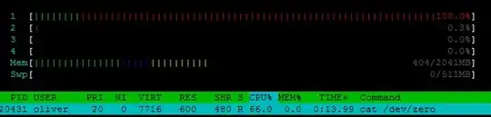

I’m currently in the process of debugging a Cacti installation and want to create CPU load to debug my CPU utilization graphs.
I tried to simply run cat /dev/zero > /dev/null, which works great but only utilizes 1 core:
Is there a better method of testing/maxing-out system resources under load?
