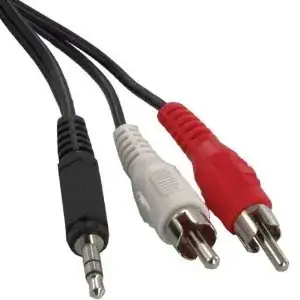

Use a 3.5 mm stereo-to-RCA cable from the RCA out of the cassette tape deck to the Line In jack of the sound card.

  • Thank you for this and thank you to everyone who responded as well. I am going to radio shack to get the proper cables and will give this a go! – Taptronic Sep 21 '09 at 15:20

I've used an older Creative Audigy sound card for input on a PC, but the issue is probably more to do with your software. Try downloading Audacity. You can use it to save your recording from the audio in and edit the files into individual tracks. I've converted several old cassettes with it and am pretty happy with the results. You'll probably need a RCA to 1/8" plug stereo Y adapter for your audio cord.

I know very little about Macs, but on the Windows machine, you can use a free tool like Audactiy to record sound from the line-in jack.
You'll need a converter cable to get the output from the cassette deck to the 1/8" input jack. They have both 1/4" to 1/8" cables, and also dual RCA to 1/8" cables.
