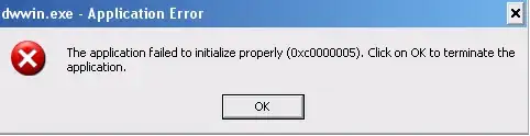

the application failed to initialize properly oxc0000005 click on ok to terminate the application

Any help would be most welcome.
Finding a Solution for the 0xC0000005 Error
since the problem is related to the sandbox, i don't think we're dealing with faulty memory, DEP is more likely to be the culprit. add the switch /NOEXECUTE=OPTIN to your boot.ini
if this doesn't solve the issue, follow the instructionx in this MSKB article to disable the postmortem debugger (Dr. Watson).
  • What should disabling Dr. Watson accomplish? By the time Dr. Watson is invoked, the program has already received an access violation exception. – bk1e Oct 20 '09 at 02:05
In Sandboxie go to CONFIGURE --> EDIT CONFIGURATION A notepad window will open... Go down to:
[DefaultBox]
Where it says.. AutoRecover=y
Change to... AutoRecover=n
BINGO! I hope that works for ya'll as well
