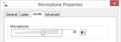

This is a real problem, even in latest Windows 8.1. I see it with my (relatively nice!) Sennheiser PC 360 headset also. To get even decent volume from the microphone I have to set absolute max level and boost:
microphone properties - boost and levels - analog
Anything under that is just way too low. Even 90 or +20 db is too low, can barely hear the mic with those settings. And the max boost means I hear background noise in the audio now too.
However, if I plug in a USB headset / mic, I don't have this problem -- microphone level can be set around 50 and is plenty loud.
So I think, sadly, the "solution" might be to avoid analog headsets. Depressing since mine is extra fancy!

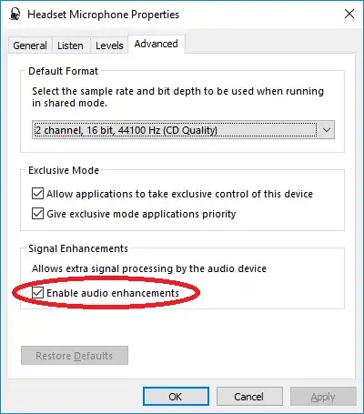

I had this issue with a podcast mic, I've not checked to see if your question was answered, but all I did was
  1. Make sure windows was up to date (which it wasn't) and
  2. I went into the microphone properties and went to the Advanced tab made sure the two options under Exclusive Mode were "unchecked"
  3. I made sure the microphone Levels were turned up including the boost slider.

I removed "enable studio enhancements" and increased my mic boost and it fixed the problem for me. I can now hear any amount of wind going into the microphone in my audio, but other people can hear me on skype. Definately not a solution for any kind of quality recording or skype interviews, but for casual use, I guess my computer mic is just very cheap.
