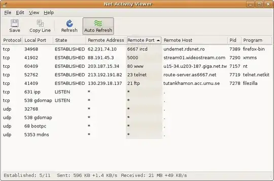

I would recommend you to use Net Activity Viewer to determine what process/service is keeping this port on listening state:
After this, Google the process name to see if there are any viruses related to this process and to this port.

  • @Nikunj Edited to Linux TCP View program. Probably netstat can't list prot related to processes. – Diogo Jul 19 '12 at 15:00
