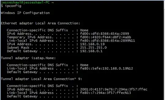

Here's the output from ipconfig:

  • Still not working out. Would you mind taking a look at the output of my ifconfig and the network settings? : https://www.dropbox.com/sh/t78qg1y2jgfoe3g/UwAOF8CsPu – jshawl Jul 22 '12 at 07:10

SOLVED! Just needed to run ipconfig when in NAT mode. Saw that inet address was 10.0.2.2 (Apparently this is the norm for mac HOST IP addresses)
Edited my windows host file such that 10.0.2.2 pointed to cpp.
