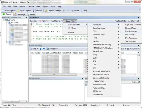

First you're going to have to get in between all that traffic. You could do this in a number of ways, the simplest of which is probably to identify if you truly need the traffic from both computers or just the traffic from a single computer.
If you need both, hook the computers up to a hub and then to the router. A hub will send all network traffic to all ports, where a switch will only send it to its intended destination.
If you only have a switch, I suppose you could rig one computer as a gateway and point the second computer towards it, but that's messy.
If you need all the traffic, even the router, place a hub after your router and hook a computer to it. This will probably only work if the traffic you're trying to capture doesn't originate from the machine you're using to capture the packets, otherwise you're going to run in to some more messy configuration.
Once you have all the traffic flowing past your computer's NIC, grab a packet sniffer (I actually prefer Windows Network Monitor over Wireshark) and start grabbing the packets. You'll probably want to filter the traffic to just display the server in question. Filters in Microsoft Network Monitor are very user friendly: enter image description here
