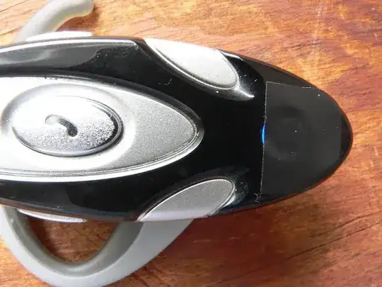

One way to prevent this is to place a small strip of clear, Scotch tape over the area.

  • I get cat hair in the hole and it makes my mouse do random crap... I tried tape, but it wasnt clear enough... I wonder if clearer tape would work – Keltari Jun 24 '13 at 20:53
  • @Keltari, maybe, just make sure to avoid getting fingerprints on the tape. `;-)` – Synetech Jun 25 '13 at 17:27
